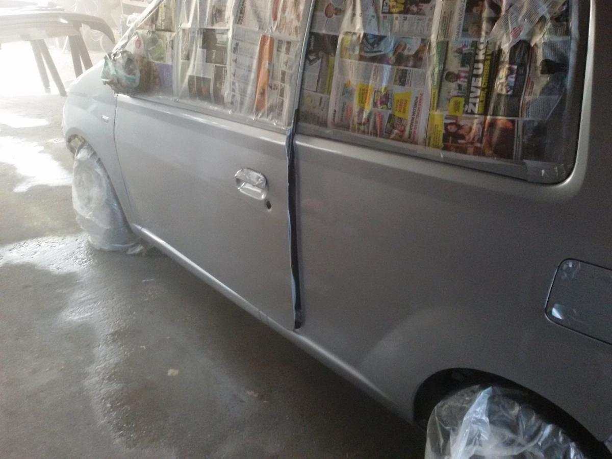

AleksaZP Posted June 19, 2016 Author Report Posted June 19, 2016 Malecki sredjen, sve na mestu Kabe 1 Quote

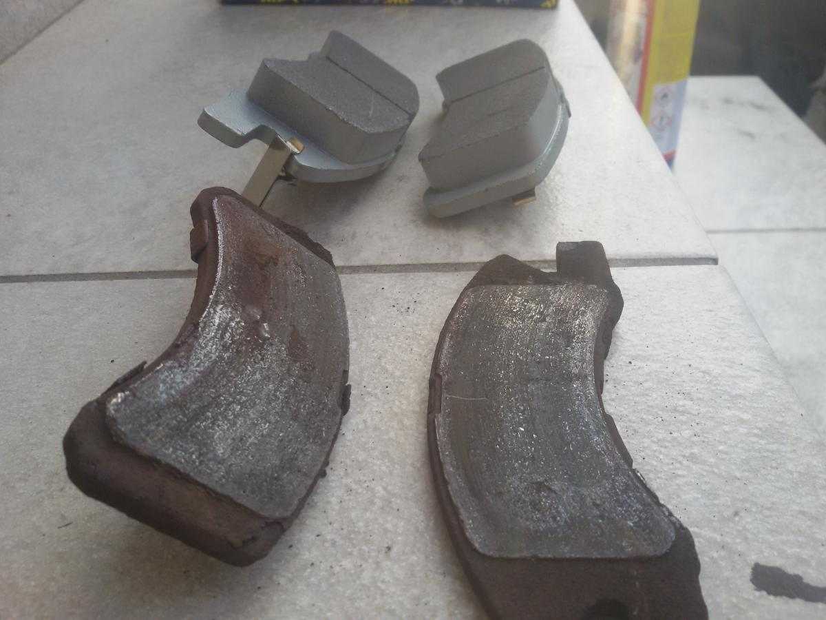

AleksaZP Posted June 16, 2017 Author Report Posted June 16, 2017 U medju vremenu posle zamene gumice, čeljust blokirala, ne primetih odma, plocice na par mm do metala, ociscen klip vraceno sve nazad, nove plocice Nipparts i to je to. 197000km: Pločice Nipparts 2000rsd Quote

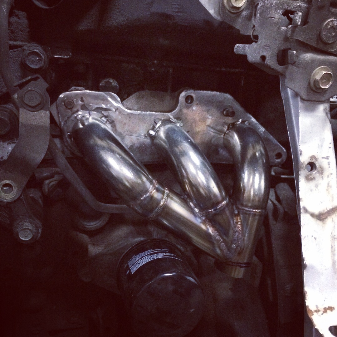

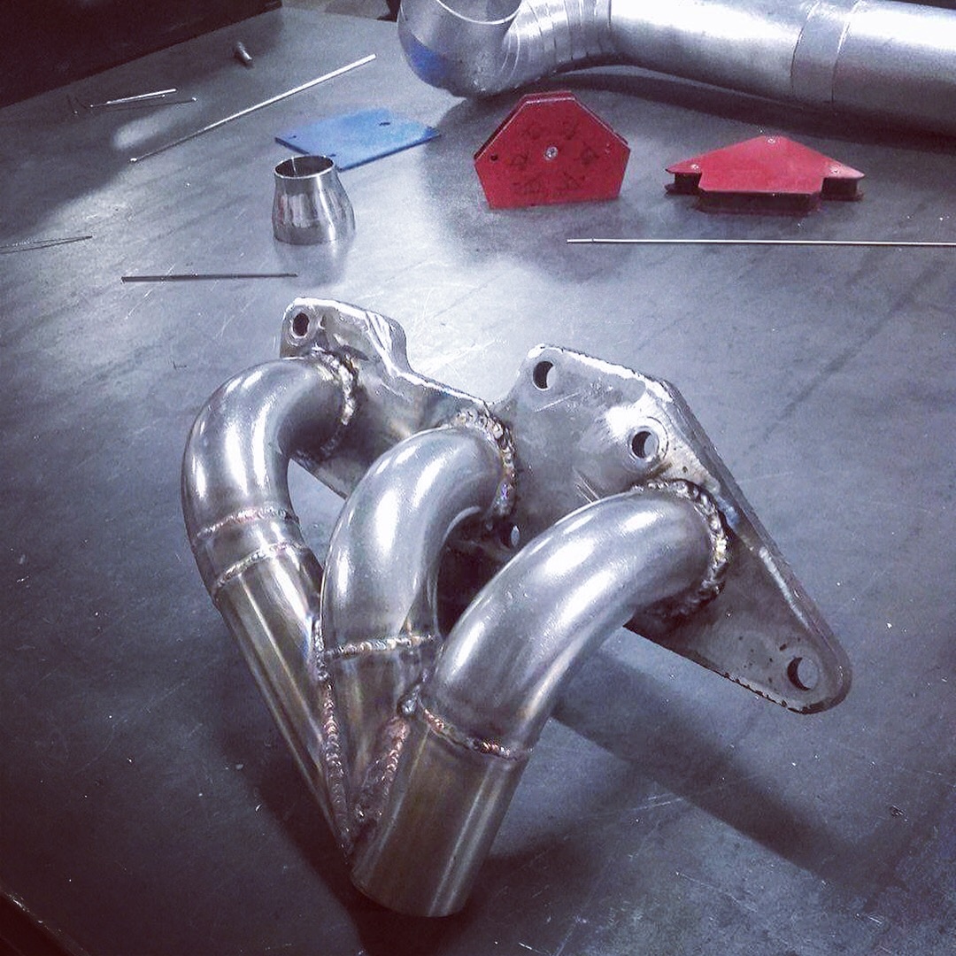

AleksaZP Posted September 16, 2017 Author Report Posted September 16, 2017 Izduvna grana fabricka pukla na par mesta a i bas je bila ne funkcionalna. Pa smo drugar koji se bavi time (CWB) i ja smislili 3-1 granu i napravismo je za 4-5 sati. Grana je od prohroma 35mmx1.5mm, fabricka je bila 32mm. Skinuli smo katalizator, drugu sondu cemo izmestiti i to je to Charger and jocak90 2 Quote

AleksaZP Posted September 23, 2017 Author Report Posted September 23, 2017 Ne bih ja to dirao ali nije bilo isplativo fabricku granu zavarivati... Quote

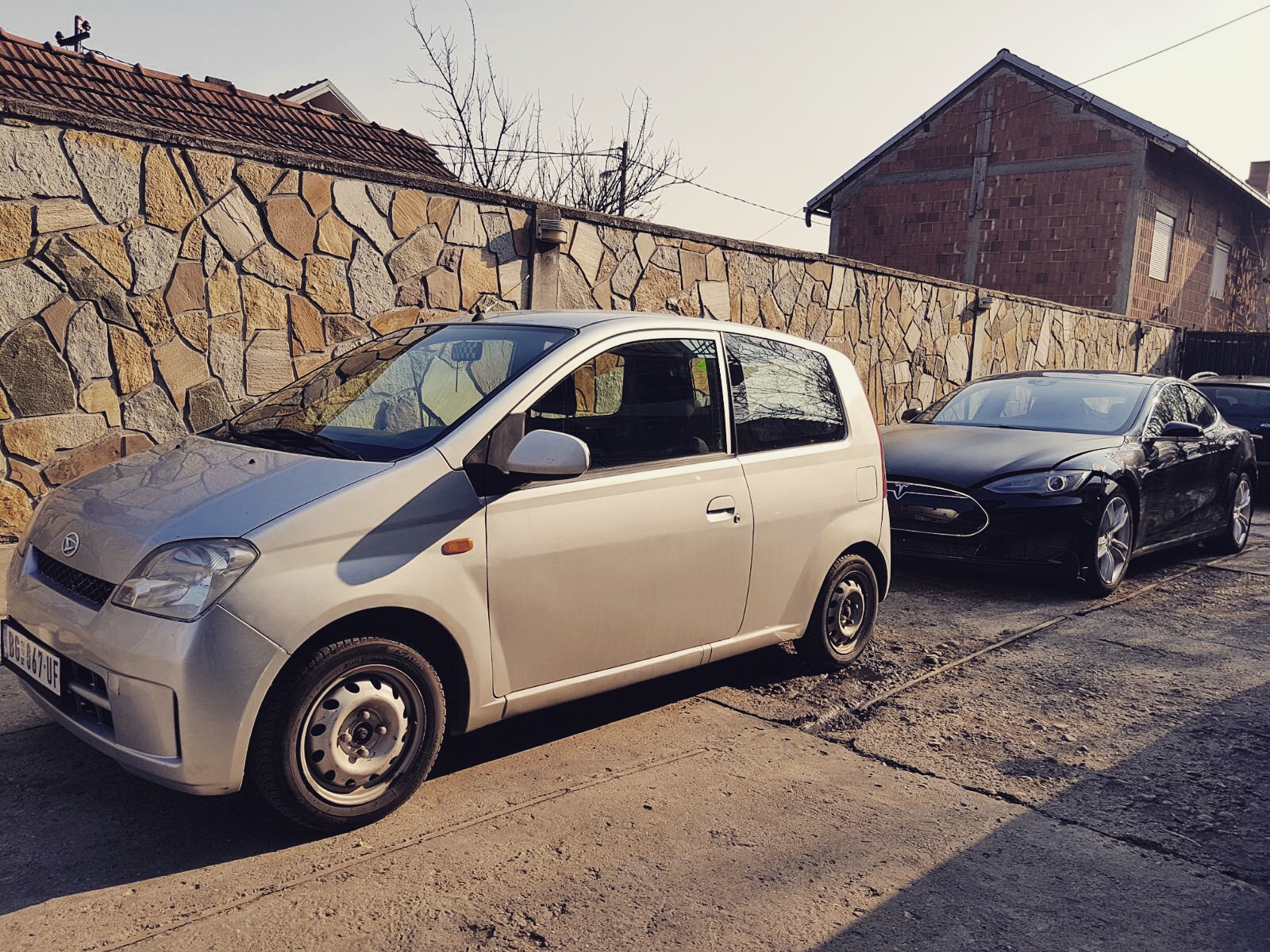

AleksaZP Posted February 6, 2018 Author Report Posted February 6, 2018 Daihatsu broj 1! 19ljuba82, DuleBP and Denny 3 Quote
mladjan Posted February 6, 2018 Report Posted February 6, 2018 Cija teslica? Sent from my iPhone using Tapatalk Quote
AleksaZP Posted February 6, 2018 Author Report Posted February 6, 2018 Tu sa Altine, auto je kao iz igrice na prvi pogled a onda shvatis da je sve vec vidjeno negde, prekidaci mercedes, abs bosch ide na iveco kombi itd itd Quote
mladjan Posted February 6, 2018 Report Posted February 6, 2018 Ima i nesto jedinstveno Sent from my iPhone using Tapatalk Quote
Gile Posted February 6, 2018 Report Posted February 6, 2018 Motor iz teolejbusa. Charger, marko_serb, AleksaZP and 1 other 2 2 Quote
